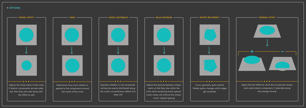

OPTIONS
The Tool should provide at least these options found in Maya, Modo and Blender:
  • Radial Offset: Adjusts the initial radius of the circle. If interior components are also selected, then they will scale along with the offset as well.
  • Twist: Determines how much rotation is applied to the components around the center of the circle.
  • Evenly Distribute: Specifies whether or not circularized vertices are evenly distributed along the circle's circumference.
  • Relax Interior: Adjusts the spacing between components so that they stay within the circle while remaining evenly spaced. Lower values will enforce the components' original spacing.
  • Rotate Reconnect: Changes which edges get connected if the initial result geometry gets twisted (check this video around 0:30 link)
  • Normal Offset: Adjust Normal Offset to move the circularized components (and interior component, if selected) along the average normal.

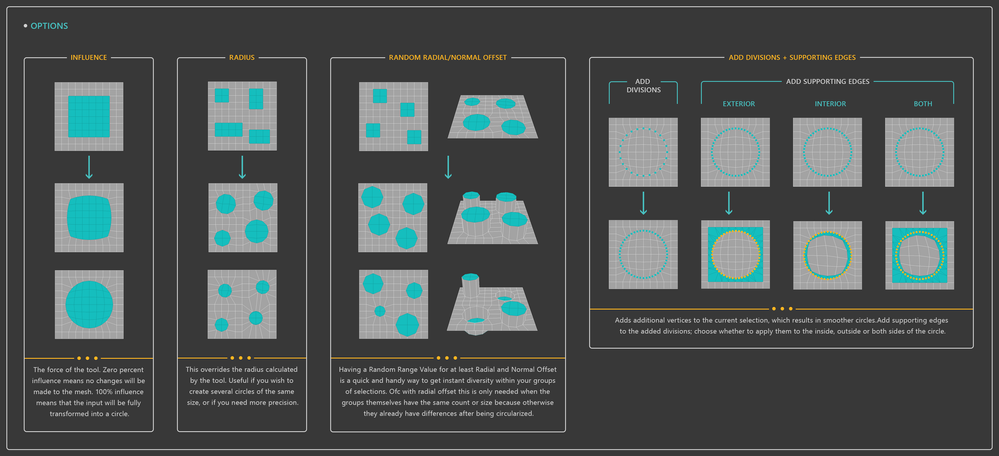

  • Influence: The force of the tool. Zero percent influence means no changes will be made to the mesh. 100% influence means that the input will be fully transformed into a circle.
  • Radius: This overrides the radius calculated by the tool. Useful if you wish to create several circles of the same size, or if you need more precision.
  • Normal Orientation: Determines which set of components normals (face or edge loops) are averaged to orient the circle.
  • Random Radial/Normal Offset: Having a Random Range Value for at least Radial and Normal Offset is a quick and handy way to get instant diversity within your groups of selections. Ofc with radial offset this is only needed when the groups themselves have the same count or size because otherwise they already have differences after being circularized.
  • Add Divisions: Adds additional vertices to the current selection, which results in smoother circles.
  • Supporting Edges: Add supporting edges to the added divisions to avoid n-gons; choose whether to apply them to the inside, outside or both sides of the circle.
