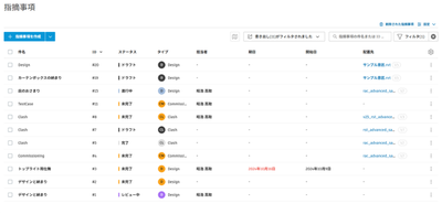

List issues
Once you've created an issue, try to display it in a list. As a general rule, issues are "public". This is different from markup, isn't it?
In Docs, on the far left menu, click Issues
You'll see all the issues set up on your project.
You can quickly access each issue. Also, the Status shows the progress of the issue.
