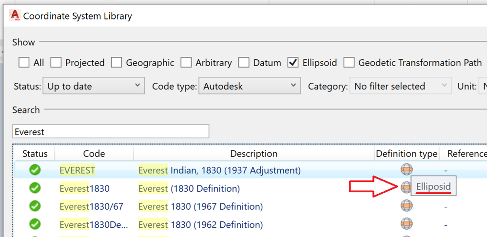

Hover your cursor over the "Elliposid" symbol. Oopsie!
I'm using 2022, so this might have been corrected in 2023.
Dave

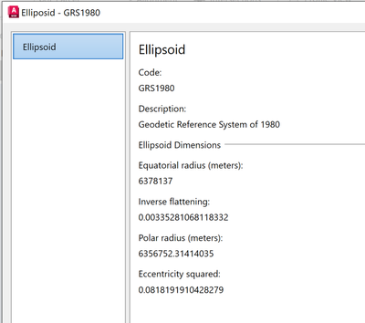

Definition of Terms are wrong in the Definition of GRS1980 Ellipsoid.
Equatorial radius should be Semimajor axis of the geodetic ellipsoid
Polar radius should be Semiminor axis of the geodetic ellipsoid
I know that's a quibble. I'm getting my terms and formulas from James Stem's white paper >>>Here<<<.
Inverse flattening should be just "flattening"
Flattening is not 0.00335281068118332. It is 0.00335281068118329
Eccentricity squared shows 0.0818191910428279. This number should be called First eccentricity.
And Eccentricity squared should indicate whether it is First or Second Eccentricity squared.
First Eccentricity Squared = (a^2 - b^2)/a^2 = 2f - f^2 = 0.0066943800229028
Second Eccentricity Squared = (a^2 - b^2)/b^2 = e^2 /1 - e^2 = 0.0067394967754810
First eccentricity of the ellipsoid = sqrt(2f-f^2) =0.0818191910428277
