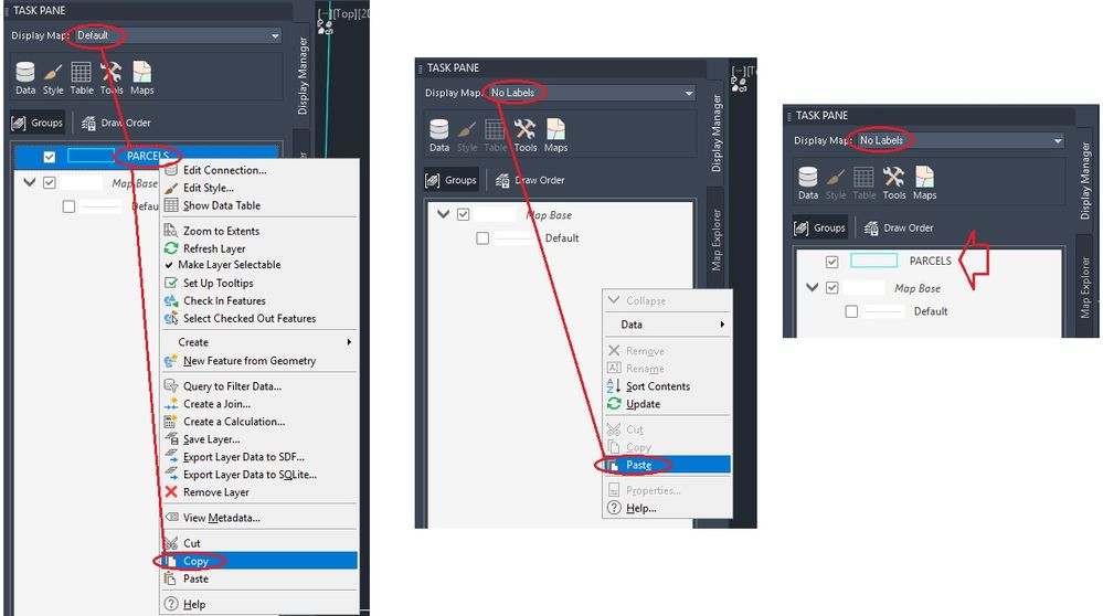

So I have been using Map3D a lot recently and I am having a great time discovering all of its limitations. I have loaded up my drawing with plenty of utility data from local council and I have spent time styling the assets and building labels that refer to lots of useful data. It is all looking good, but the drawing is so slow that finishing my work has become difficult. I just want to freeze / turn off the labels quickly so I can finish some markups, but I can't figure out how this is done. I also can't freeze any of the layers any map objects are on which is very frustrating. What am I doing wrong?
I don't want to convert the labels to MTEXT, this defeats the purpose of having dynamic labels?  I can't seem to move any objects on layers, this is super annoying!

Hi @m_kingdon
You can turn off the labels and keep the linework.
I don't know whether hiding the labels will speed up performance but you can try it anyway.
Here's an example:
1. I have a parcel shapefile.  It's labeled with the attribute AREA and has a  custom suffix inserted right after it, SF (square feet). The Map Task Pane indicates Display Map: Default.
<<The Default is WYSIWYG (what-you-see-is-what-you-get) which means the display as shown in modelspace is the Default Map style. As I change (or customize) the appearance of the shapefile in modelspace, the Default Style will change too. >>
Image-1Image-1
2. I can create a NEW map style as shown below. I'll name it 'No Labels.'
Image-2Image-2
3. In Display Map dropdown, I make sure Default is shown.....then....Highlight Parcels in Task Pane=>Right click=>Copy=>then back to Display Map Dropdown=>No Labels style=>Paste contents of my clipboard so Parcels appears in the Task Pane (red arrow).
Image-3Image-3
4. Next, I make sure No Labels is shown in the dropdown (No Labels is critical!!), then delete the labels for the Parcels in the Style Editor

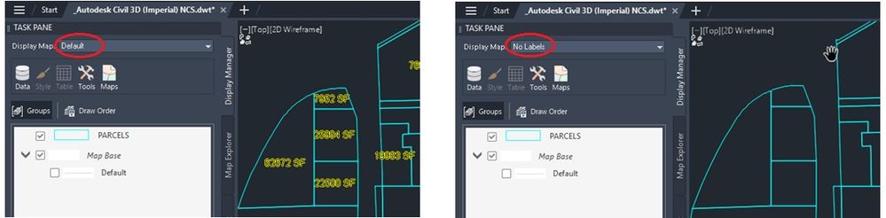

<<Deleting like this in the Style Editor only deletes the labels for the No Labels map style. It doesn't have any effect on Default Style, therefore the labels will remain under Default Style.>>
In the dropdown, I can toggle the map styles between Default and No Labels. Depending on which Map Style is currently shown in the dropdown, the labels will be displayed or not displayed (refer to image-4 below).
Image-4Image-4

Excellent solution, you also resolved my next question regarding viewports.  Cheers very much for spending the time to illustrate this workflow so clearly!
