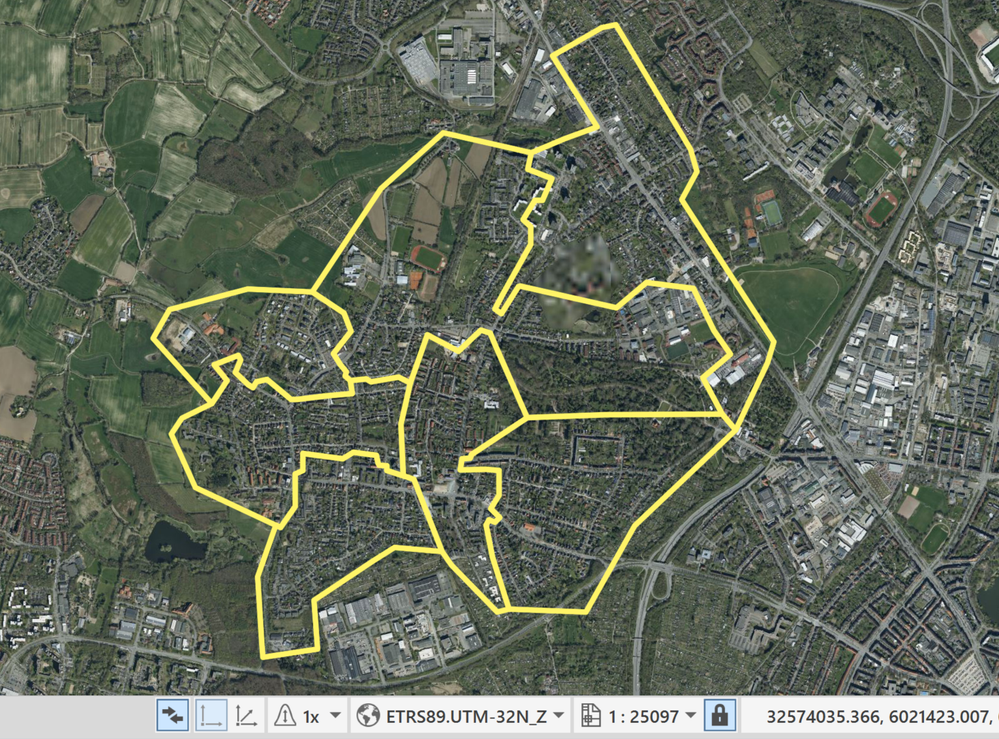

OK, here you go. Attached please find CSLibrary_ETRS89.UTM-32N_Z_CS.XML. Use Command >>>MAPCSLIBRARYIMPORT<<< to add it to your MAPCSLIBRARY Definitions. Then when you assign ETRS89.UTM-32N_Z Coordinate System to your drawing, your shapefile plops in at the correct place.

OmG perfect man thanks alot!! ❤️
