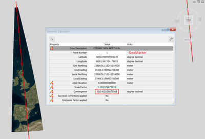

Pointdump
Carlos,
To give a visual, the GeoMarker at the center of Bing Live Maps extents is normally on the Central Meridian, so would be a Convergence of zero. Wierdly, the pie-shaped extents of PT-TM06/ETRS89 are rotated.

caruivo
Well, I tried to open the same file in another computer that also use the same auto-registered coordinate system, and the rotation of the north doesn't happen.. so I deleted the auto registered coordinate system, an created it again (by opening a file with that) and it works.
I have no idea what could happened.
