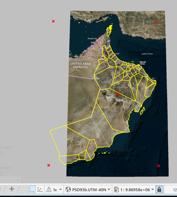

The 7-Parameter Geodetic Transformation PDOSurvey93b_to_WGS84 is not the same as >>>EPSG:1439 PSD93 to WGS 84(1)<<<. Signs are reversed.
Edit: From >>>This Civil 3D Forum Thread<<<.
Further Edit: Bing Live Maps Extents not using the EPSG:3440 definition:
WGS84 bounds:
51.99 16.59
59.91 26.58
Dave Stoll

Re: PDOSurvey93b_to_WGS84
In general, the EPSG 7 parameter transformations have 2 forms: position-vector and coordinate frame.  The difference between the two is direction of rotation.  It looks there were a few changes on this - there is an "obsolete" PDOSurvey93a transformation with matching rotation sign that can be used via "PSD93a.UTM-39N" and "PSD93a.UTM-40N" CRS.
I've logged a ticket for this.
