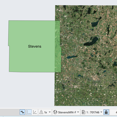

I have a drawing with the Stevens County, MN coordinate system setup. When I turn on the Geolocation Image (Bing) it does not encompass the correct county. The coordinate system parameters are correct per published coordinate system parameters. The shape files I imported (with mapimport) appear to fall into the correct location. When I use a WMS service the image falls into the correct place. It is just the Geolocation Image is the issue. The image appears to fall into the correct position but does not encompass the right county. See my attached dwg. Stevens County is in Blue, with surrounding counties for reference. I am experiencing this issue in both Civil 3D 2019 & 2023. Any help is greatly appreciated.

No, the drawing you posted has the same issue. See the screen shot that @Pointdump posted. It shows the aerial image extents not around Stevens County. The image itself is in the right location as the county to the east is Pope County and the image appears correct over that county, but the extents of the image does not carry into and encompass Stevens County.

I looked at the coordinate system definition >>>Here<<< which agrees with >>>ESRI:103783<<<. There are 2 problems with the MAPCSLIBRARY definition. First one is easy to fix. Duplicate the StevensMN-F Coordinate System and edit the extents. Attached, please find my drawing with the new "StevensMN-F_Shift" Coordinate System. (Click OK to add the definition to your MAPCSLIBRARY.)
The second problem is that Minnesota uses a different size Ellipsoid than NAD83:
Semi-major Axis (meters): 6378502.761
Semi-minor Axis (meters): 6357116.84
About that I don't know what to do other than create a new Datum and Ellipsoid definition.

I had some time this morning to completely fix the Autodesk definition of the Stevens County Coordinate System. Attached, please find Stevens County_Adj.dwg with these new definitions which should tag along:
NAD83_HARN/MN_Stevens (Datum)
GRS_1980_Adj_MN_Stevens (Ellipsoid)
HARN/MN_Stevens_to_WGS84 (Geodetic Transformation)
NAD83_HARN_Adj_Stevens (PROJCS)
Check them out in MAPCSLIBRARY.
