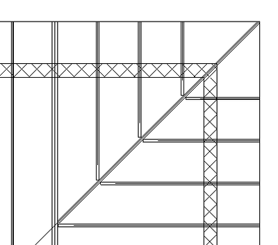

It would be nice to be able to change the detail level (fine, coarse, etc.) with filters. This would allow us to filter ducts and show ducts smaller than a certain size as a single line.

In AutoCAD ist was normal to Draw large pipes as double lines (= Fine) and smaller pipes as single lines (=Coarse), Please add Detail level to filters, so we can make this a possibility.

Hello All. I came across this thread when trying to figure out how to hide the symbolic lines that my view was creating in a particular family when set to coarse. I would definitely like to see the addition of a detail level column to filters but I found a solution to my problem that may be transferable to some of yours.
My situation: I have structural framing set to coarse with filters set on structural usage so that steel girders appear one way, joists another, a beams(other) another. The problem I have had is that we show wood framing members at medium detail level to better represent ply # and alignment. I've modified the simple 2x wood framing family to include multiple ply instance parameters and to show up in coarse views but it still generates the symbolic line in the center which is a problem for odd ply members. There is a parameter within the family that changes the symbolic representation from project settings to from family. Since the family no longer contained the the original symbolic line, it no longer shows up in my view.
From Project Settings:
From Family:
If you're willing to modify the families that you use, you could control the symbolic lines that are based off the detail level with parameters. You can have more than one symbolic line in the family, and more that one line type(subcategory) if the system family permits. I did this with my steel girder family to show (3) lines, with 2 different line types controlled by filter.
