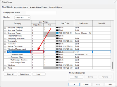

Revit 2025. This wall selected (blue) is not being cut, so I did a manual override of the hatch and now I have these THICK hatch lines...it makes no sense...
Obviously no linework setting for fill patterns, just fill regions. What is controlling this hatch lineweight?????????????

Message 74 of 81

carlPAW5H
Apologies, I meant $3000!! $300 would be an amazing deal indeed! And regarding the AI example, it was hyperbole, but it is still physically possible to code an entire software in a day using AI, it just wanted to make a point. And the frustration is because the entire industry's consensus is that Autodesk are monopolistic extortionists. They have no excuse in the year 2025 for not having some of the basic core features other softwares have had for decades.
Message 77 of 81
carlPAW5H
So I found the culprit.
This "umbrella" line-weight seems to control hatch region line weights on all walls that do not fall within any of the other defined categories below. I don't know 100% how this line weight works but it fixed the problem for me.
Good luck others.
Message 78 of 81
jens.lathouwersMR29R
Ah, I see — that’s just the object styles, so that’s the first lineweight to check. It’s actually a basic piece of functionality in the software. Glad you found it!
