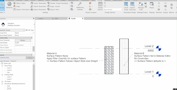

RDAOU
@RobDraw
(Assuming Hatch Pattern they are referring to Surface Patterns)
Overridden surface pattern will follow the Projection Line weight in object style....So technically it is possible if one applies the surface pattern as an Override (ex: using View Filter) ... + add to a view template should it be applicable to more than one view...
Downside would be that pattern overrides will be limited to Drafting Patterns ...
