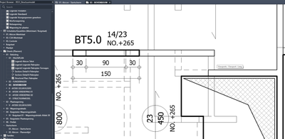

Hi everyone,
my wall patterns seem to be lost when upgrading my template te Revit 2024.
I'm in structural discipline and my walls are 100% transparant with a brickwork hatch pattern.
In 2023 and before this was all correct but now in 2024 they seem to be missing.
View filter settings:
Same settings in Revit 2023 shows like it should be:
Only when I turn off my transparancy it gets fixed, but then I can't see my beams anymore obviously.
Any reason why this was changed?

I checked this already and no it's not the case:
When I turn my wall transparancy to 100% in structural discipline the hatch patterns disappears.
Can anyone try this and confirm this as well?

Just noticed when printing in structural view the wall patterns do appear on my PDF print, so it's a visual bug.
In Revit:
in PDF print:

Printing vector or raster doesn't make a difference, the end result is always perfectly fine (PDF prints correctly).
It's INSIDE the Revit workspace where the bug appears. The hatches don't show up.
I also updated my computer's graphics card drivers, but the problem persists.

It tried the snowden sample as a reference:
same error
See attached video to show you the problem.
