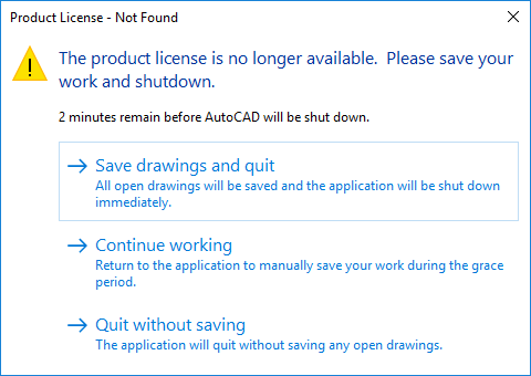

Problem:  You have Autodesk 2020 software installed, but are now unable to simply change the licensing from Single User to Multi-User, Networked Licensed, or Trial version.
Reason:  Autodesk has changed how the Autodesk 2020 products are licensed and apparently there is no simple way to do this from Help > About to Manage Licenses, or by deleting LGS file information as in previous versions.
Solution:  With the introduction of the Autodesk 2020 software release, changing the licensing now requires commands to be entered via an elevated command prompt.

UPDATE v1.4
Due to the common occurrence of Autodesk 2020 License Timeout issues similar to the image below, I have decided to make an additional option in my command script.
Error when Autodesk Desktop Licensing Service is not runningError when Autodesk Desktop Licensing Service is not running
The update to the script will now have the option to start this service.  The service is called the Autodesk Desktop Licensing Service and must be running for your product to function properly on its license type.
This file runs the AdskLicensingService.exe file as a resident process.  Note:  You can also run this file manually to test for errors and to run as a resident file if the service itself is not running.
This file is required to runThis file is required to run
Choose Option #6 in the attached script (zipped below) to start the service.  If the service is not started, it will start the service.  If the service is already running, it will simply inform you that the requested service has already been started.
If you wish to test this file for errors, you can launch it manually from this location:
C:\Program Files (x86)\Common Files\Autodesk Shared\AdskLicensing\Current\AdskLicensingService
The result of the launch should look similar to this:
Successful LaunchSuccessful Launch
If you get any errors similar to invalid character ' \x00' looking for beginning of value then your configuration has a major error and your Autodesk 2020 product line will not work .  I am currently working on this issue.
I will keep this thread updated as necessary.

I really appreciate the time and effort put into the solution for this problem. I tried it and after I still end up getting the error. I even set the delay to 30sec(3000000). I'm shouldn't be getting that much latency since I'm us-based and not using a vpn or other network gateway. Also tried a repair and reinstalling.
Message 7 of 57
TravisNave
What is your exact issue?
Travis Nave Send TravisNave a Private Message                                             Need help in your post? Mention me with @TravisNave
My Expert Contributions to the
Autodesk Forums:
FLEXnet License Admin | MSI Cleanup Utility | .NET Framework Cleanup Tool | IPv6 NLM Fix | adskflex.opt Options File | Combine .LIC Files
Message 8 of 57
Well it's the same problem, License Timeout and forces me to save and quit or just quit.
I tried another solution before yours, which was deleting some files, can't find the website now but it was an official post I believe from Autodesk.
So I tried you're script, runs and resets it without any errors.
As I stated above I've also changed the timing value via your script
Verified the services are running
repaired and reinstalled AutoCad 2020.
Actually trying to install 2020 was difficult. Kept failing, but finally got it and every since 2nd start of the program it started this.
Message 9 of 57
TravisNave
See if your Autodesk Desktop Licensing Service is started. That's been
causing a lot of the pain in the last few days. It just won't stay
resident. My updated script adds a #6 to start it manually.

Ya it is (verified with task manager and says it's already running in the script), seems to not immediately kick me out if I don't open a drawing. As soon as I open a drawing the timeout comes up
Also I don't know if I've noticed it before but opening it hangs a long time at "ACConnectWebServices.arx". Since I upgraded to 2020, with the problem, it takes a full minute to open.
Message 11 of 57
TravisNave
Interesting. Network version?
When the timeout happens, is the service still running?

running 2020 since its launch with no issue, all told I have close to 200
hours in the software before this appeared. And is not PC specific either
because in desperation I loaded to a secondary machine that ran for about 4
hours before it crashed as well. Two completely different installs, two
different builds of windows.
Message 20 of 57
TravisNave
I had the same happen to one of my engineers. No explanation for it.
