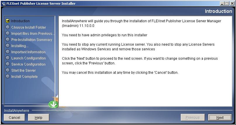

Installing and Configuring the Flexera FLEXnet® License Administrator
In addition to the Autodesk Network License Manager, Autodesk products can be configured to use the 3rd party Flexera FLEXnet License Administrator service to manage licenses for the Autodesk network applications.  Other vendors may also use the FLEXnet service.  Therefore, it is important to recognize that if other vendors are using the FlexLM (LMTOOLS) then you should not run the web-interface FLEXnet in conjunction with it.  Only one license manager type should be used for all products.
For new installations of FLEXnet, please use the following procedure:
  1. FLEXnet License Administrator is not supplied by Autodesk.  To obtain the installation files for this application, you need to download the license administrator files (lmadmin*.exe) from the following website:
    http://www.globes.com/support/fnp_utilities_download.htm

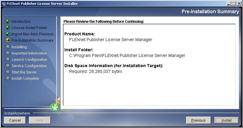

  2. Once the installation has been uncompressed you will be presented with the installation screen.  On the Introduction, click Next.

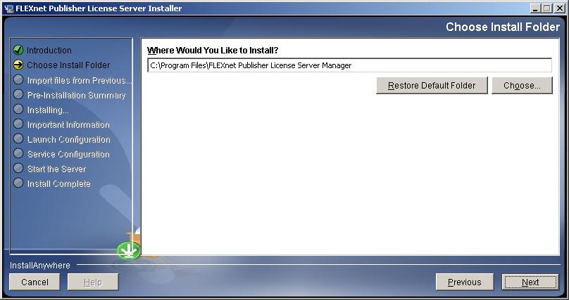

  3. Choose the install folder. Default is C:\Program Files\FLEXnet Publisher License Server Manager.  Click Next to continue.

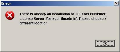

    Note:  You cannot upgrade an existing license manager.  If you receive the following error, either rename the existing folder (recommended) or choose a new location for installation.

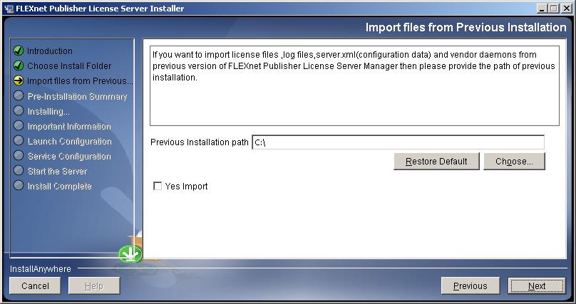

  4. Regardless of any pre-existing license manager, do not choose to import any settings. Click Next to continue.
  5. On the Pre-Installation Summary, review the settings and click Install

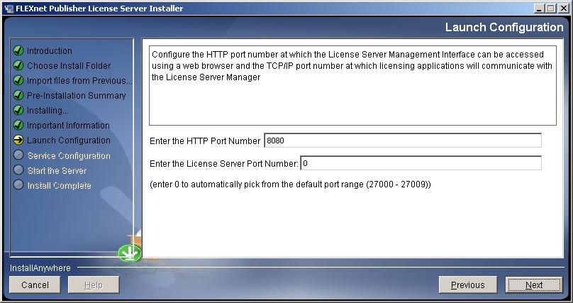

  7. Choose the default setting for launch configuration unless there is a port conflict on an existing web service on 8080.  The License Server port number will default to 27000 ~ 27009.  Click Next to continue.

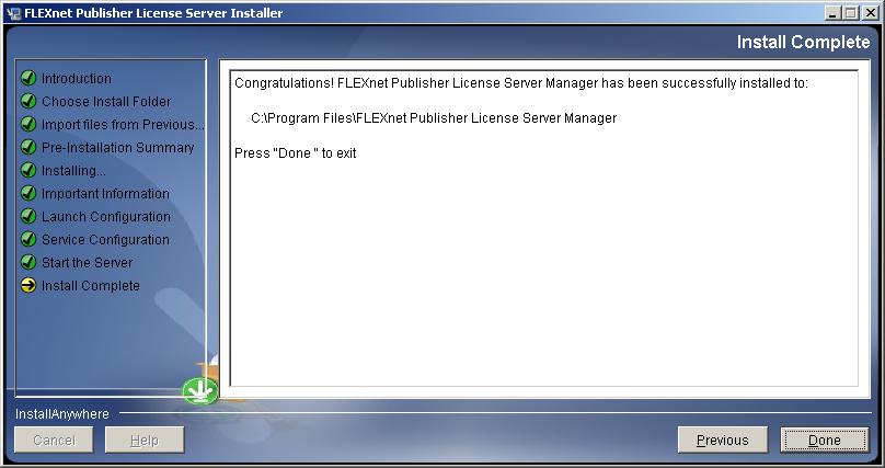

  9. When prompted to launch the License Server Manager, check the box that reads Start server now and click Next to continue.
  10. Click Done to complete the install process.

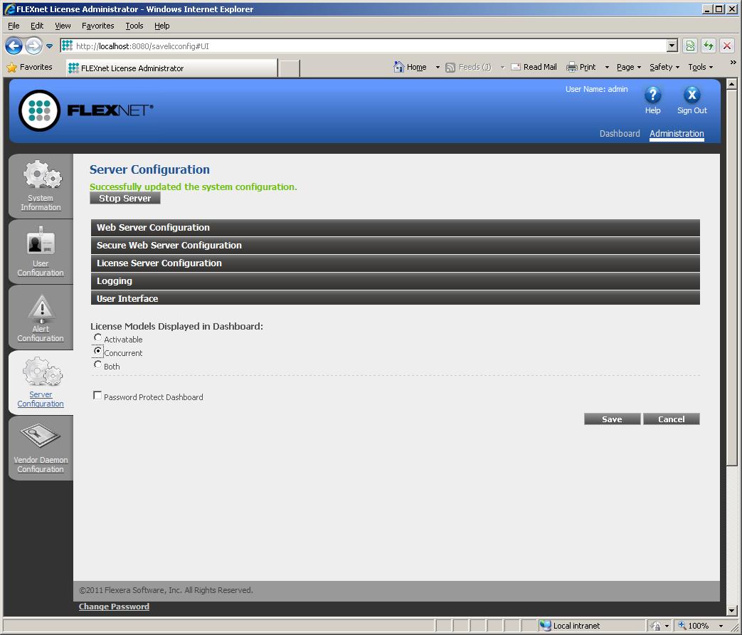

  12. To configure the FLEXnet License Administrator Dashboard, click Administration in the upper right-hand corner.  You will be required to login as admin on the initial login.
    Username: admin
    Password: admin
    Upon a successful login, you will immediately be asked to change your admin password. Please choose a secure password that can be easily remembered.  Later you can add additional users either created locally or from your Domain Controller.
    Click Submit and Save the new admin password to continue.
    On the User Configuration screen, you can add additional administrators as local users or from your Domain Controller.

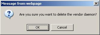

  13. Before you can configure the adskflex vendor daemon for your Autodesk product, you will first be required to delete the existing demo setup. Choose Vendor Daemon Configuration from the left-side navigation.
    Locate the vendor daemon listed as demo and choose Delete.
    When the confirmation dialog box appears, click OK to delete.

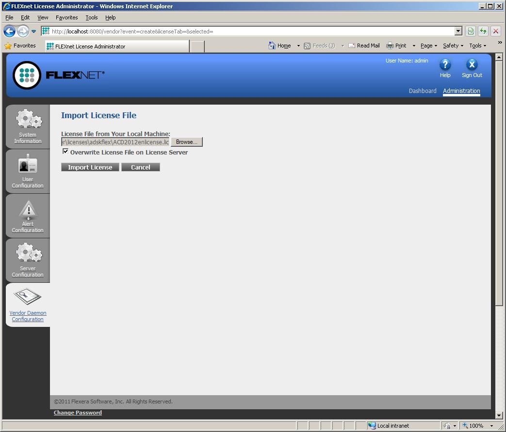

  15. While still on the Vendor Daemon Configuration screen, click Browse… to navigate to the location where you saved the license file in the previous step. Select the file and then click Import License to continue.
  16. Once the license file has been imported, you should receive warning that service is unable to start because the adskflex.exe vendor file required by this license is missing.
    The warning will provide the location where it expects the adskflex.exe vendor file to be placed.

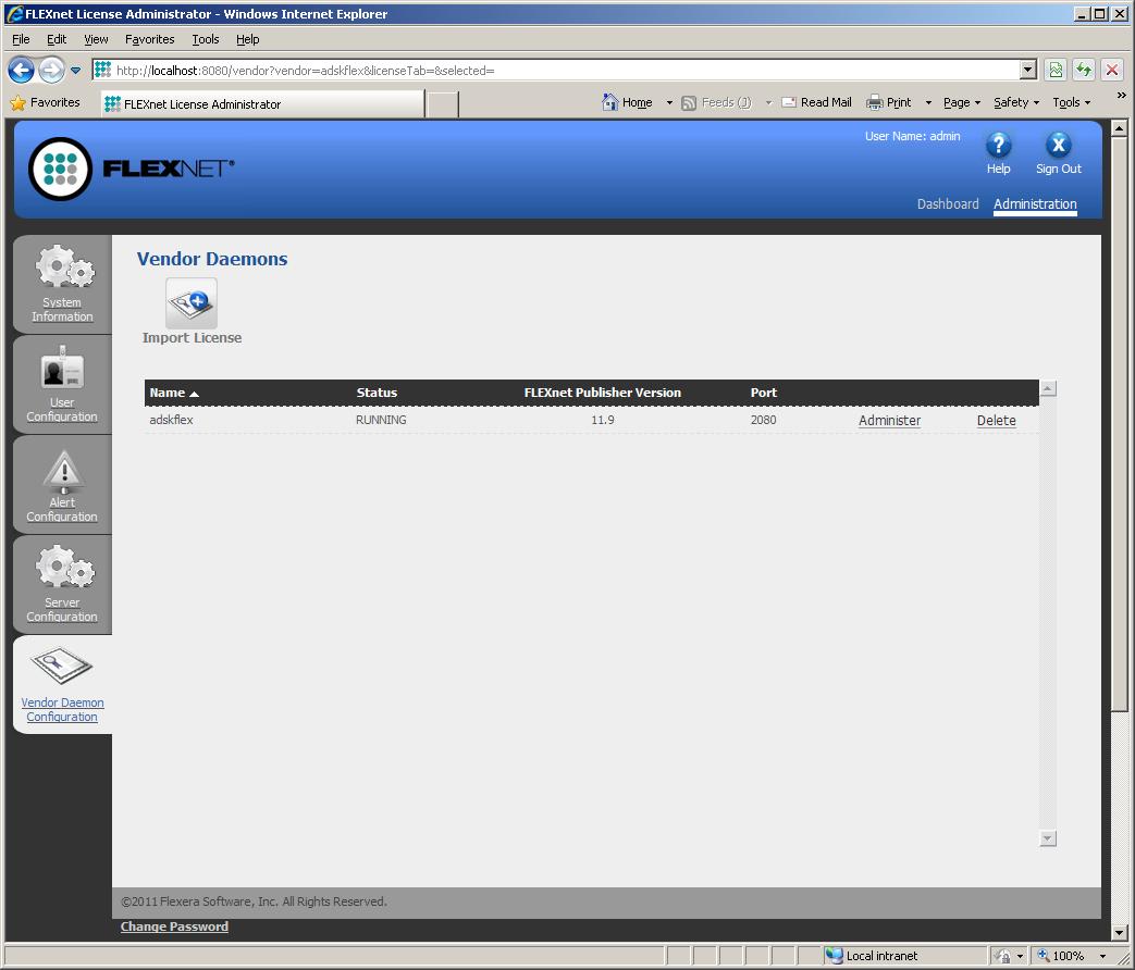

  17. On the Vendor Daemon Configuration screen, locate the adskflex vendor daemon and click Administer to make changes to the configuration.
    In the box labeled Vendor Daemon Location:, place the relative path to the adskflex.exe vendor file.  The path should now read:
    adskflex\adskflex.exe
    Click Save.  The status should change to: Successfully updated the vendor daemon configuration.
    You can now click Start on the vendor daemon to start the FLEXnet License Administrator.

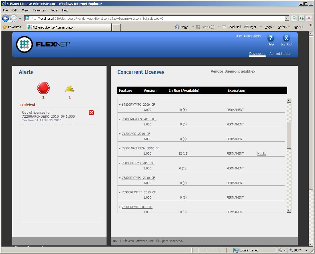

  18. The status of the adskflex vendor daemon should now be listed as RUNNING and using port 2080.  The status may be pending, but will eventually show as running if configured properly and refreshed.

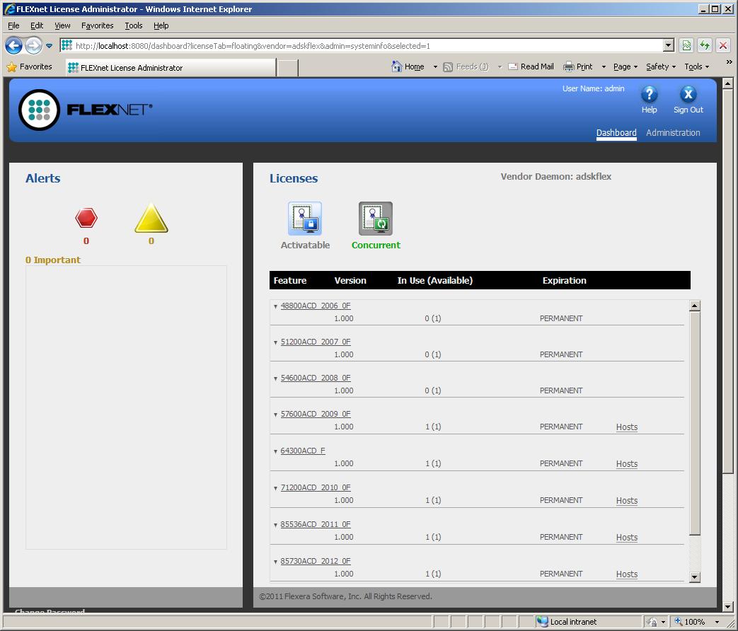

  19. Once running, click Dashboard on the upper-right corner and choose Concurrent to display your network licenses.
    You can clear any errors or warnings listed in the alerts from initial setup and configuration.  Alerts can be modified from the Alert Configuration screen under Administration.  Additionally, you can set the Dashboard to only display Concurrent license models by selecting the Concurrent radio button on the User Interface section of the Server Configuration screen under AdministrationNote:  All other options should remain defaults unless you have specific reason to change them due to preference or conflict.

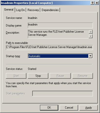

Optional:
To modify the startup behavior of the service, see the Startup type under Windows Services in Administrative Tools (services.msc)
