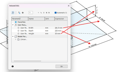

In your original problem description, you mentioned that your Design Intent was to change some dimensions.
In the Attached file Edit the Named Parameters Width, Depth and Height as needed to match your true Design Intent.
Message 55 of 66
3D_Ken
I almost always put in parameters for anything that might change.  You can see this in the prior versions that I have posted.
I also have gone back and put in big changes to see if I could break anything, and everything worked as I hoped it would.
