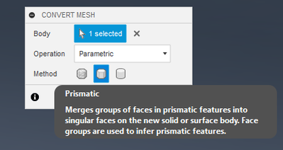

"The best" idea is to model this thing from scratch with the native, parametric CAD tools in Fusion. That is also going to be a bit of work, but with teh added advantage that you'll learn how to use the tools.
The quickest solution, if it would actually work,  would be to use the Prismatic conversion:
 But in this case it does not convert successfully and leaves out some faces. I attempted to direct edit the mesh to correct face croups, but that only helped marginally.
That conversion is also only available for paid subscriptions.
The least favorable method is what you described. Convert directly into a faceted body. Coplanar faces can be "cleaned up" by selecting a face and hit the delete button. That will merge coplanar faces into one face. This can alter the geometry if attention isn't paid. Rounded areas will need to remain rounded.
Perhaps that is enough to allow you to modify the geometry. The attached file contains such an attempt.

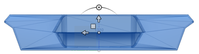

Start a new file.
Import the stl.
Turn on the visibility of the Origin.
Using the arrows move the geometry such that the origin is approximately midpoint of the bottom horizontal line (don't worry about getting perfect - just as close as you can eyeball...
Check it from a side view (shouldn't need to move).
Select OK.

From the Mesh tab select Move and set to Bodies and select the Mesh Body.
Move to center in the rectangle (remember - we are moving by eye - so movement distance may be different than mine).

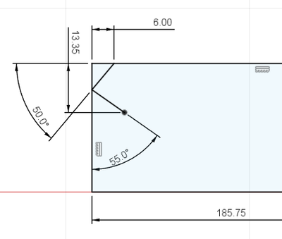

Add this 50° angle.

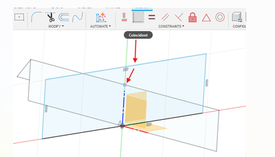

Finish sketch and then start a New Sketch on the YZ plane.
Sketch the rectangle approximately as shown.
Hide the Mesh Body and select p on the keyboard for Project.
Select the top horizontal line from Sketch1.
This will project the line as a point into Sketch2.
Add a Coincident Constraint between the top Horizontal line in Sketch2 and the Point projected from Sketch1.
Observe the color changes of the lines as we constraint them...

I would like to understand how you calculated the angles you specified.
Did you draw temporary sketch lines and measure them?
File attached.
