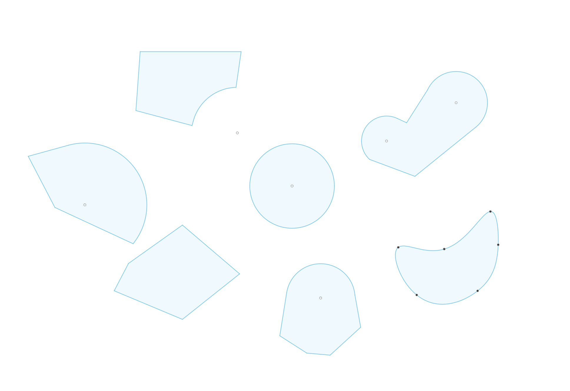

I'm trying to find a consistent and accurate API method of finding the orientation of profiles similar to the profiles visible in the attached photo.
I read that closed single curve profiles such as circles and ellipses always are CCW but I'm struggling to find a method that can return the correct direction of  other multi-curve sketch profiles for me to use it with the correct negative or positive offset value to always insure the result is inside the selected profile?
Any ideas on how I might achieve that?

Offseting a closed sketch in Fusion360 is always negative to the inside and positive to the outside, and that applies to API as well. Looking at the sketches you've attached, they are all closed sketches, so you should always have a consistant offset to the inside if the value is negative, and to the outside if it's positive.
The real challange is offseting an openned sketch, like a polyline for example, in that case you'll always need to provide a direction point for Fusion API to understand which dircetion you're offseting to when the value is positive, and if you think about it, it is a MUST, because if you create a single line manually in Fusion sketch workspace, you'll see that it's hard to predict which side is positive and which is negative, meaning in API you'll have to come up with a CONSISTANT logic that applies to the case you're dealing with.
I've been using Fusion 360 API for over 5 years, and each case is a unique one when it comes to the direction of offset, as I always define a criteria for the direction point based on the project at hand.

The offset direction is not always inside on a negative offset value in my experience as seen in this screen grab. The script I used is below and has created an inside offset for circle and an outside offset for just a regular 2 point rectangle. The arrows in the constraint indicate which way the offset was created. The sketch profiles have been created in advance manually as will be the case in my application, if that makes any difference. In further testing it seems to flip the direction of offset if the 2 point rectangle is drawn from bottom left to top right vs top left to bottom right etc. That indicates that the rectangle orientation flips (reversed normal) when drawn from different corners. Maybe you have always drawn the profiles with the same inherent orientation but I recommend you have a play since it is the same result if done manually.
