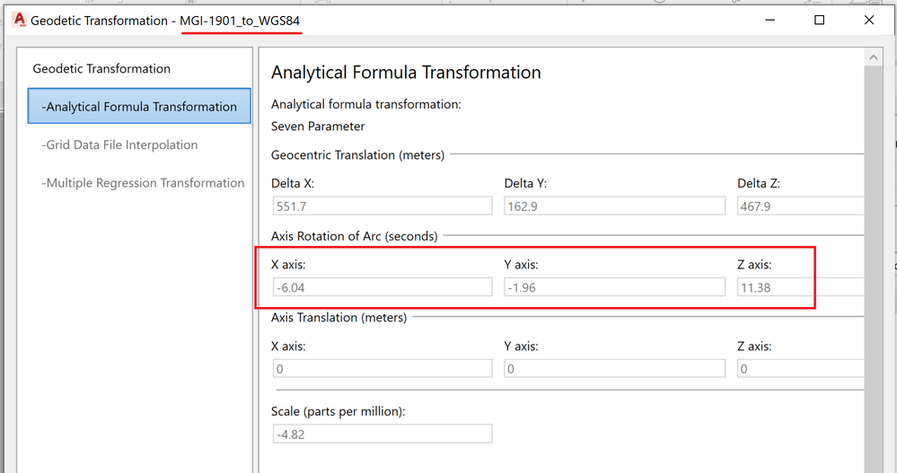

>>>EPSG:3964, MGI 1901 to WGS 84 (4)<<< shows the 7-Parameter Geodetic Transformation as (551.7, 162.9, 467.9, 6.04, 1.96, -11.38, -4.82)
MGI-1901_to_WGS84 in MAPCSLIBRARY has the signs reversed on Axis Rotation of Arc (seconds):(551.7, 162.9, 467.9, -6.04, -1.96, 11.38, -4.82)
