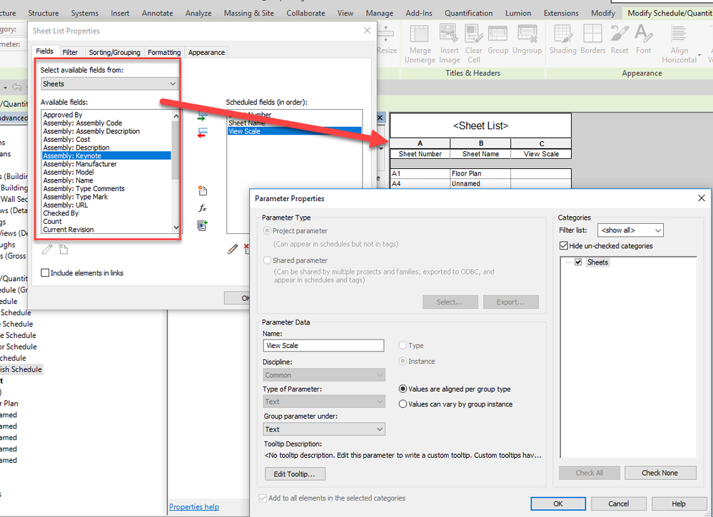

Currently it is not possible to add the paramter "Scale" to the sheet list schedule. This is a requirement for us in 99% of the projects, to have this information here, as it aids the client and contractor when overlooking the project.
I get around it, by inserting a shared parameter, both in titleblock and sheet schedule. But it feels counterproductive to do so, as the information is right there in the parameter.

Please make it possible to add view scale in sheet lists. The information is already available but the function is not added to the program.

Add "View Scale" Parameter in Sheet List Schedule. In my opinion, one of the essential parameters in this list.
Although it can be solved with Dynamo , But This is the default requirement.

Make view information available in a sheet list. Directly not as embedded schedule please.View scale i sheet list.jpg
