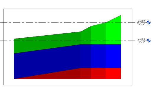

As the image below shows, I did create three stacked topo surfaces in Revit to represent the strata boundaries, and exported these as polyface meshes to AutoCAD. There, I followed a procedure I found in the Autodesk Knowledgebase:
Issue:You have a polyface mesh object and you need to convert it to a NURBS Surface object.
Solution:To convert a polyface mesh object to a NURBS Surface object:
  • Type FACETERSMOOTHLEV into the command line and press Enter. [The text said FACETRESMOOTHELEV, but that is an error.]
  • Set the system variable to 0 and press Enter.
  • Type CONVTOMESH into the command line and press Enter. Then select the objects and press Enter.
  • Type CONVTOSURFACE into the command line and press Enter. Select the objects and press Enter.
Then I created a closed polyline around the perimeter of the topos, extruded it above and below them, and then SLICEd the solid with the surfaces to create the strata. Colored these and imported the CAD into Revit. But as you can see, the colors do not come through when cut by a section box, if that is one result you are looking for.
The strata DO appear correctly when cut by a section however:
All in all, interesting to have done, but far from a smooth workflow even if you are only doing it once. Frequent updates would really slow things down. And... you can't explode the CAD import - everything disappears with an error message.
