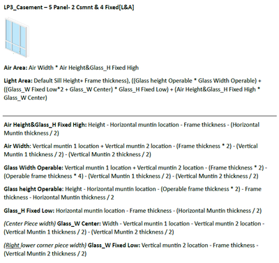

Below is an example of the formulas needed. To get the areas we need to basically find the total height and width of the glass and the operable window. This tends to be done by taking the total height and width and then subtracting the mullions from the total, but the formulas are different for each window layout.
