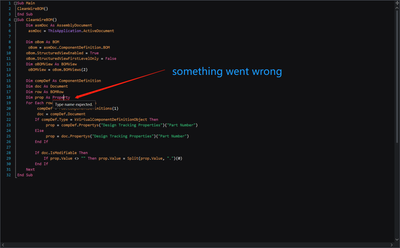

lihouxin065
Sub Main CleanWireBOM() End Sub Sub CleanWireBOM() Dim asmDoc As AssemblyDocument asmDoc = ThisApplication.ActiveDocument Dim oBom As BOM oBom = asmDoc.ComponentDefinition.BOM oBom.StructuredViewEnabled = True oBom.StructuredViewFirstLevelOnly = False Dim oBOMView As BOMView oBOMView = oBom.BOMViews(2) Dim compDef As ComponentDefinition Dim doc As Document Dim row As BOMRow Dim prop As Property For Each row In oBOMView.BOMRows compDef = row.ComponentDefinitions(1) doc = compDef.Document If compDef.Type = kVirtualComponentDefinitionObject Then prop = compDef.Propertys("Design Tracking Properties")("Part Number") Else prop = doc.Propertys("Design Tracking Properties")("Part Number") End If If doc.IsModifiable Then If prop.Value <> "" Then prop.Value = Split(prop.Value, ".")(0) End If Next End Sub

A few things when posting the code you can use the special editor to keep the formatting. See below.
So the property object needs a reference to Inventor so write it it in one of two ways
Inventor.Property
[Property]
In the find and replace of "Set" it unfortunately took it from "PropertySets" which is required.  The below code is functioning.
Sub Main
	CleanWireBOM()
End Sub
Sub CleanWireBOM()
	Dim oBom As BOM
	Dim doc As Document
	Dim row As BOMRow
	Dim prop As Inventor.Property
			prop = compDef.PropertySets("Design Tracking Properties")("Part Number")
		Else
			prop = doc.PropertySets("Design Tracking Properties")("Part Number")
		End If
		End If
	Next
End Sub
Regards
Alan
