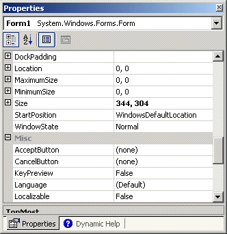

Working with IDEs like Visual Studio, I find this feature very useful. I could see it also being useful for modelling.
The idea is to make a new customization dockable window the shows different display values based on the environment. This would allow users to customize the information required for their specific workflow and not have to sift through the iProps that they leave blank or disregard. The functionality would be similar to a form, but more suited to the environment, and DOCKABLE.
