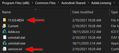

I need to have my entire company transitioned from network licenses to named user and I'm working with IT to run the licensing service update in the background but I need to test the IT package to make sure it works. For that to happen I need to know what version of the licensing service I have now so I can compare it with the version post installation but I can't seem to find a way to see the version of what I have now neither found any post with that information here or one any Autodesk websites I found.
I tried my Desktop App but I only get the spinning wheel and it never opens. The Windows apps manager doesn't have it either. Any help would be greatly appreciated. Thank you.

The following folder will hold the current version:
%CommonProgramFiles(x86)%\Autodesk Shared\AdskLicensing\Current\
That should give you a start.  Also, I have a batch file to reset licensing.  If it would help your IT / CAD Manager, please feel free to use it and modify it to run automagically.  The link is in my signature.

Amazing, thanks Travis. That's exactly what I needed. It seems the version is in the folder name and the version.ini file shown below. I should now be able to tell if the licensing update worked after installing it.
You have one of the most useful signatures I've seen.  🙂
I'll need to reset them for version 2019, it seems the one in your signature is for 2020-2023. I'm already working with IT to package the update then the reset together in a single install, it should be fine. I'm using the licensing support tool to reset it.
