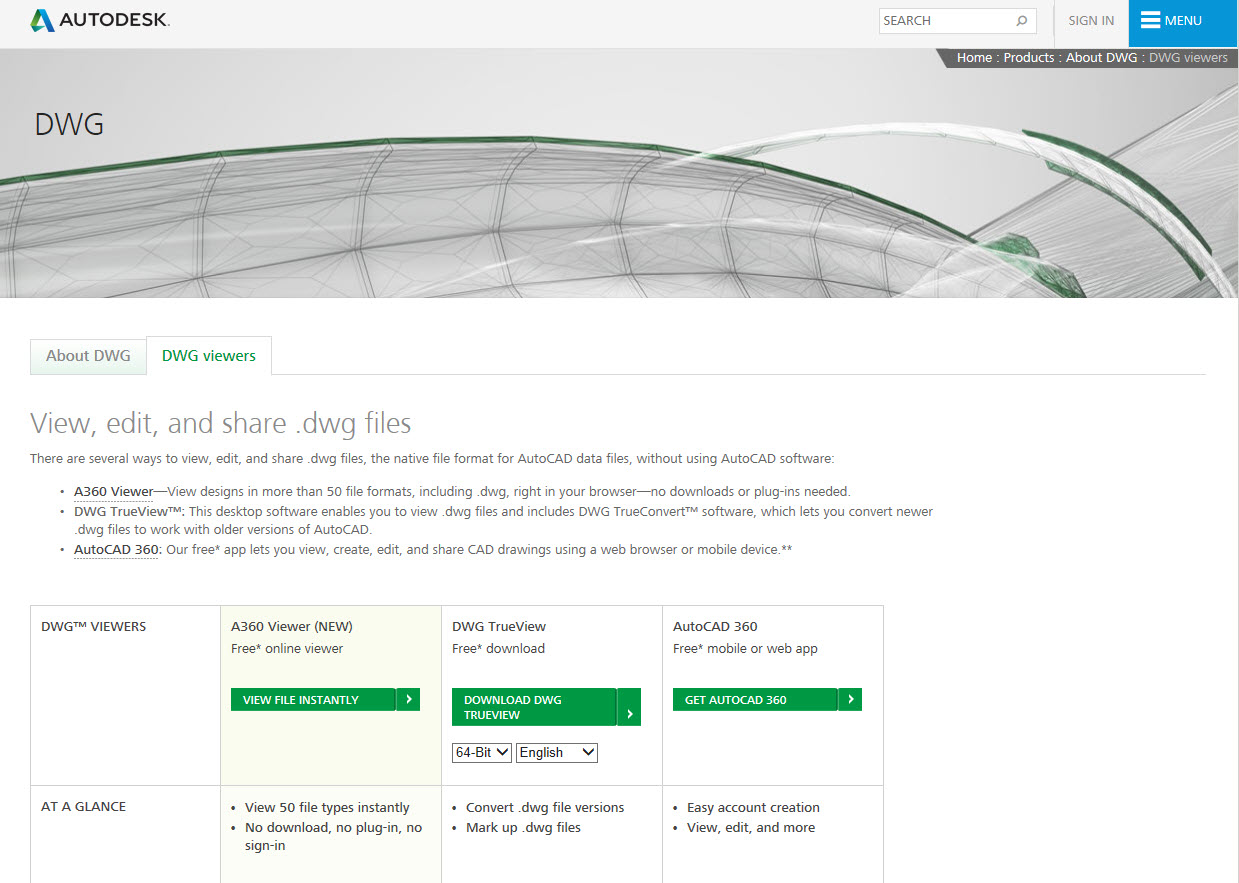

Hello.
I am trying to install DWG TrueView on my computer but get several error messages and then the installation is not able to be completed.
Installation sequence:
1. I run DWGTrueView_2017_Enu_64bit.sfx.exe which I have downloaded from your webbpage. See image Installation_0.jpg.
2. The installation starts. I press "Install". See image Installation_1.jpg.
3. First error message occur. I press ok on the error box. See image Installation_2.jpg.
4. Second error message occur. I press ok on the error box. See image Installation_3.jpg.
5. Third error message occur. I press ok on the error box. See image Installation_4.jpg.
6. The installation menu comes back. I press "Install" See image Installation_1.jpg.
7. The licence agreement menu comes up. I press "I Accept" and then "Next".  See image Installation_5.jpg.
8. The installmenu comes up. All boxes exept Back and Cancel are avalible. I have to cancel the installation.  See image Installation_6.jpg.
Please help me so I can install TrueView.
