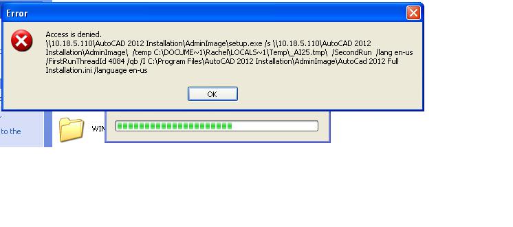

I’ve setup a network deployment server.  All licenses can be checked out.  However, when I tried to install in the client PC, I have the following error during Setup initializing:
The deployment shared folder already set to simple share with Everyone having Full Access Rights (Tested that users can read & write the folder).  I have also turn off the firewall and antivirus in the client pc as well as the server. FYI, the same installation file works well when i install it as a stand alone trial version.  Attached is the log file created today when trying to install. What could possibly be the problem? I am running out of options troubleshooting this problem.

That message sure seems to point to access problems to the deployment location, but just for fun, delete the contents of the client %temp% location. If this is over-full, it can cause weird errors during deployment.
Also, double check that you can ping the deployment server by hostname, not just ip. Maybe a dns issue?
Your log file is devoid of information. Is that the log file from the server or the client? Have you looked at both? Maybe more information will be available in the other log file.

Thanks for your suggestion.  Unfortunetely, i still get the same error.
I can ping the server using host name.  I've also cleared the Temp folder, and the log file in the server shows that everything has been installed successfully.
Any more suggestions?

Is there a chance that your permissions start too low in the share tree?
I usually make a share called Autodesk Deployments, full control to all users at this level and below, and then have a deployment folder for each different Autodesk program under that. Do your access rights start this high? If you're piggybacking this to a different share, maybe make a dedicated share like I do and see if that helps.

The file and folder permissions also need to have full write access.  The 'everyone' account should have full rights to the share and folder permissions both.  The local user needs to have local administrator rights to the machine.  Any kind of denial is implicit over granted access, so double-check your permissions, OU, and/or GPO on the domain as well.

I've asked my collegue, a network guy to check on all those.  Seems everything is what it should be.  I've even tried to copy the whole deployment folder to the client pc and run the installation. But as expected, the same error pops up.  I've also tried to to run the installation within the server.  And that works.  So it is quite confirmed that it has something to do with network or sharing permission.
Is there any alternative ways? Is there a way for me to do the client installation offline, then later connect to grab the license from the server? I am so going to format the server already.

Install Microsoft Visual C++ 2010 Redistributable (x86) Failed Installation aborted, Result=1603
This is a common issue and has less to do with your deployment and more to do with a prerequisite installer failure.  See my KB on this issue here:
http://forums.autodesk.com/t5/Installation-Licensing/Some-Products-Fail-to-Install-Result-1603/m-p/3...
Also, on a side note, you are not required to create a deployment for network installation as you were in older versions.  You can install the network version direct from media or download if you prefer.  Just a thought...
