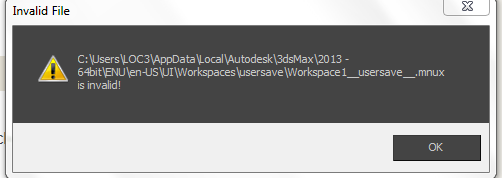

I was able to install my student version of 3d max 2013 and activate the key the day before yesterday without incident and was able to open the software.
I went to open it yesterday, once I click the desktop icon, the software would load the plug-ins but when it was time to start, I got an error popup titled "Invalid File" and it referenced a file c:user\appdata\local\...... in the message.
Also when I looked at the error report details, it stated: unhandled exceptions
I uninstalled and re-installed and this did not work.
I download the most recent update 5 and this did not work.
Any suggestions would be greatly appreciated.
Thank you

This is the error I get when starting 3d max. Tried uninstalling and reinstalling and even updating driver. Nothings seems to work. Need Help!
Message 4 of 12
TravisNave
Sounds like an invalid file in your TEMP folder.  Might clean out the %TEMP% location of all files.  If that doesn't work, consider a system restore back to the day it did work.

I had the same issue -
here's how I fixed it:
Make sure 3DS Max is closed
"Go to C:\Users\<username>\AppData\Local\Autodesk\3dsMax\2014 - 64bit (32bit if using it)"
Rename the "ENU" file to "ENUOld"
Open 3DS Max again
That should fix it.
