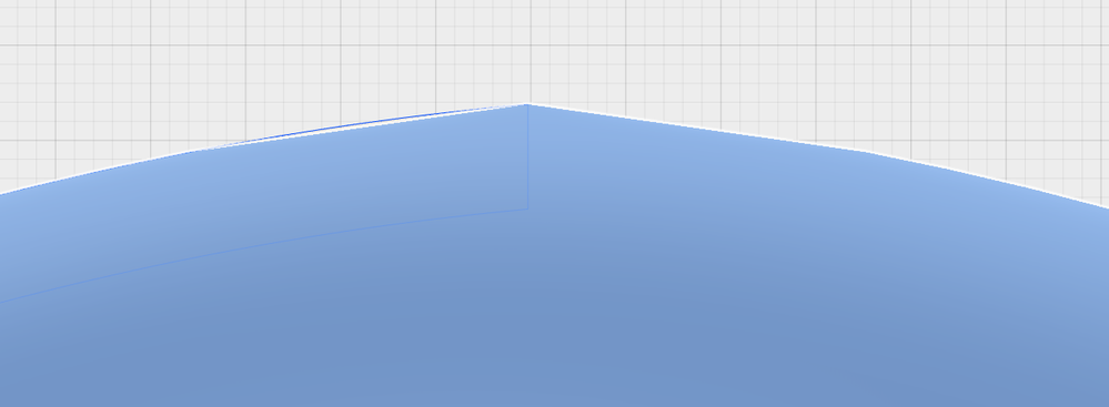

Hi all,
Sorry for my english, i'm French.

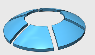

I try to make a Dome of R2-D2, i managed to create the panels of the top, but now I should make a hole on a face of one of these panels, is it possible?
The hole
As the surface is spherical!! I don't found
A big thanks
Best regards,
Budi67

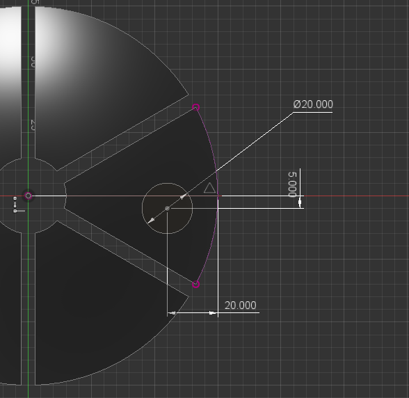

HughesTooling
Just create a sketch and project the edges of one panels and dimension the circle off of the reference geometry you project into the sketch. Then extrude cut using the circle.

I don't understand all, but I has to redo at first the dome because I had imported it of 123d.
But by making the dome with a revolution, the top is not round, any idéa ?
Message 6 of 39
HughesTooling
Make sure you have a vertical\horizontal constraint between the arc centre, arc end and the axis to revolve around.

Ok, it's all good, it's my fault, the dome is not a circle but a ellipse.

budi67
I have tryed with the projection but It is not what I would like.

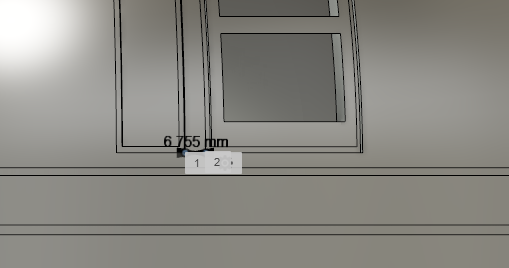

I also noticed, by making a cutting in view that my panels are not just, of needs they one the just air, but below it crosses it with the dome.
Seen that I begin, me has to not make the operations correctly.

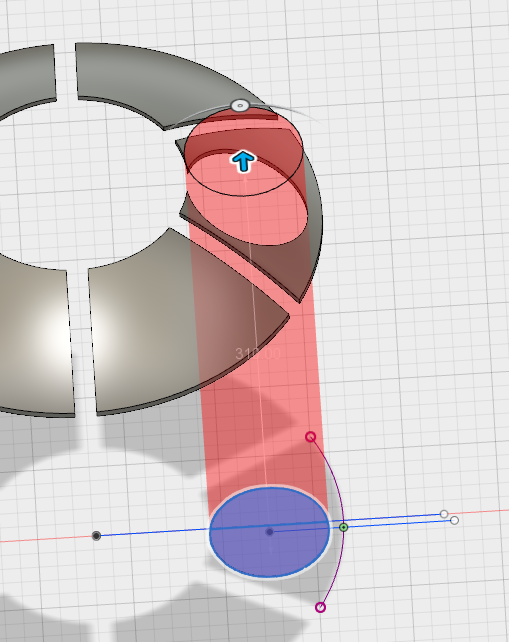

I_Forge_KC
This is one way to do this.
If the dome shape was perfectly round, I would just use a tangent constraint on the line - but because it is ellipsoidal, the tangent constraint does not work. By selecting the two end points of the curve, I can approximate what the slope would be between them.
Note that the distance between the two lines is of no consequence as long as your extrude cut extends far enough.
This method can be adapted to work at a specific angle as well (for example 45 degrees). In that case the floating line would be dimensioned against a vertical or horizontal line to give the degree measurement.

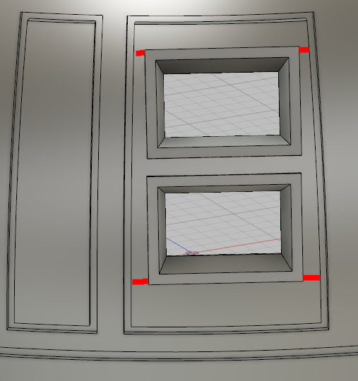

budi67
Sorry but i have another problem, i have try to make panels at the bottom Dome.
I tried a method which I considered just, but the measures are not correct.
The 2 etching are not parallel
There, I swim !!, it is all the same infuriating not to find.

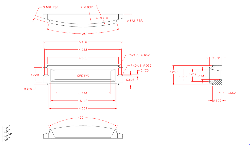

But I need your expert help, I have another part to be modelled but I do not arrive there, I have already tried several times, but i don't know how to make.
I does not even know by or to begin Man Frustrated
One thank you beforehand
