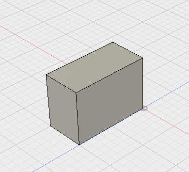

@wessel8EGAYHi there, if I were not wrong, your intention is to modify each faces of your model by "Create Form" or "Sculpting" environment.
A simple way to do that is to use the Convert Function at "Utilities" at  "Create Form", select the type of face to be converted, use form edit to edit the face. Then End the create form function and perform a "Replace Face" function at the Modify manual.
Bear in mind that when you ended the "Create Form function" the two faces are there. The T-Splint and the B-Rep. You have to select the faces to be replace. Before doing that, you might have to dim out one of the faces before doing that. At the Parametric Mode, the newly edited face is still there after the replace face operations. You can move the edited face away from the original face by moving it in the Create Form Environment. Then you can see the effect better.
A few screen shots here to show you:
A box is formed, a Brep body
 Select Create Form and select Convert at the Utilities Manual
 Select the face to be converted, select the type of face, this time I selected Brep
A T Spline face is formed
 Use Form Edit to modify the face
 End Create Form and select Replace face at the Modify Manual
 Dim out the Edited face and select the face to be replaced as Source Faces
 Light up the Edited face and select that as "Target Face" Your solid is modified. But remember, the Edited face is still there. You can dim it out again. Do not delete that at the parametric Mode
Hope that works for you!

@PhilProcarioJr@wessel8EGAYThanks for pointing that out. But depending what he wanted to do, according to his video, he wanted to change the faces. Even if a hole was there before the conversion, after the replace face function the hole will still be there but modified somewhat.
Edited, a missing picture added back:

@wessel8EGAYHi, thanks for your reply. I made a typo error. In fact, you do not have to go back to Create Form to move the "Surface  Body" away from the block.
If you look closely to my other post, you will notice that I moved the "Body 2" away from the modified face. Body 2 is a surface, not a closed solid. When you replace the face the original face will be changed but the "Body 2" surface will still be there. That might be the characteristic of the parametric mode. All history recorded.  You can right click on "Body 2" at the "Browser Tree" and select "Move" and drag the resulting manipuator to move the "Body 2" surface away. Then you can see the result better. Or just "Dim" out the light bulb of Body 2.
