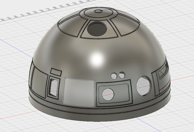

Hi all,
Sorry for my english, i'm French.
I try to make a Dome of R2-D2, i managed to create the panels of the top, but now I should make a hole on a face of one of these panels, is it possible?
The hole
As the surface is spherical!! I don't found
A big thanks
Best regards,
Budi67

I have another problem, i must yet cut the dome in multiple parts to print him.
But I do not arrive there, How to cut by following the red line
A big thanks

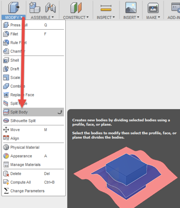

Message 36 of 39
TheCADWhisperer
@budi67 wrote:
How to cut by following the red line...
 Sketch the line and then Split Body.
If you modeled with symmetry about the origin - you might be able to use one of the origin planes for the split rather than creating a new sketch.

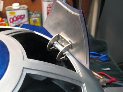

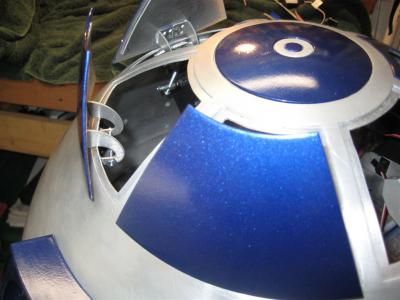

Hi all,
I once again come back to you because I try to make some things, but in vain.
I would like to integrate hinges, but I does not know how to take myself there.
I have already tried several times unsuccessfully, I would want that panels open as on the photo, which would be the procedure to begin
The dome makes a thickness of 8mm
A big thanks
Budi67
