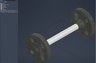

I propose, as an example, to create a dynamic pipeline, which will consist of a self-created pipe part and 2 flanges. Among the parameters, we will have the conditional diameter and length of the pipe. So let's get started:
  • First, let's create a standard part in the form of a round pipe (dimensions are not important);
  • Let's create an assembly and place a round pipe in it. So far, we do not tie, but place 2 flanges from the white library of components in our assembly. I placed the flange according to the standardDIN EN 1092-1 Welding Neck Flange Type 11 - PN 10 , the size does not matter, it is important for us that these flanges are placed as standard (As Standard). Do not forget to connect all the elements and save the assembly;
  • Now in the assembly we need to create parameters, which later we will place in the mold and control our dynamic pipeline block. Create a piping length parameter and a drop-down text list parameter;
For training there, 4 diameter options are enough, but you are not limited in the depth of creating your cases.
  • Now we need to write logic in the form of an internal iLogic rule in the assembly. So we create a rule and write the following logic:

Parameter("Трубка:1", "d2") = dLength - (d_TF * 2) 'Довжина трубки
In this code, I want to draw your attention to the parameters d1, d2 and d0 in the element The tube is the outer diameter, length and wall thickness, respectively. Next, you should pay attention to the method of replacing an element from the component library. It occurs through the snippet Components.AddContentCenterPart(), it can be downloaded from the iLogic Assemblies/Components section, respectively, or in a faster way by right-clicking on the element in the browser and selecting the following:
* - Unfortunately, iLogic cannot always generate a snippet automatically, in this case I wrote the path to the file manually.
And finally, we need to explain what happens in the last line, where we adjust the length of the tube using a formula. This formula is necessary to compensate for the thickness of the flanges, which change their size from different types.
