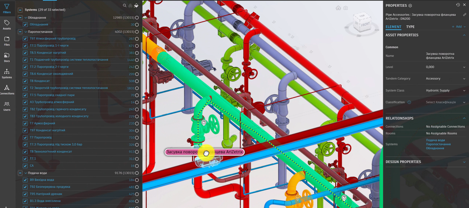

Autodesk Tandem allows you not only to view the model, but also to interactively work with the logic of systems: from node to node, by objects that are logically related to each other, and not just geometrically. An engineer does not need to manually track the pipe route in Revit or view dozens of sheets — Tandem allows you to build chains, from source to consumer.
How does it work?
Import from ACC: The model comes from the Autodesk Construction Cloud (ACC) environment.
Data Mapping: elements receive attributes — for example, system, diameter, material, service areas.
Digital logic: Based on attributes, you can build logical connections — for example, "this air duct is connected to ventilation unit X and supplies air to room Y."
Trace: Tandem visualizes the route of the system, allows you to highlight it in the context of the model, filter it by parameters, and — importantly — document changes.

We use Tandem for complex areas with a high density of engineering — in particular, where there are many intersections and level changes. For example, the section between the heating station and the distribution unit with 7 parallel engineering systems. Tandem allows you to quickly and accurately verify the route, compare it with drawings, and most importantly, fix it as it is.
