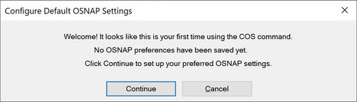

When the COS command is entered at the command line, the program reads your saved OSNAP settings from the Windows Registry. If this is your first time using the program and no settings exist yet, the program opens a greeting dialog box and asks for permission to create and save OSNAP preferences.
Once Continue is pressed, the Object Snap Defaults dialog opens to specify and update favourite OSNAP settings. Clicking the Update Defaults button stores these preferences in the Windows per‑user Registry at: HKEY_CURRENT_USER\Software\Autodesk\AutoLISP\Osnap.This ensures your custom settings persist across AutoCAD sessions and even computer restarts. Writing under HKEY_CURRENT_USER is a standard, per‑user practice that AutoCAD already uses to store preferences. It affects only the signed‑in profile and does not require admin rights. To update the defaults later, run the CONFIGOSNAP command to reopen the dialog.
