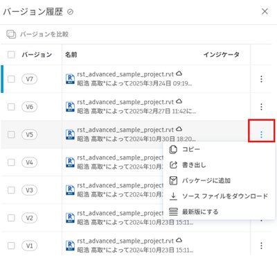

To get past versions of a file
Click on the 3-dot leader to the far right of each version.
To retrieve past versions, use Copy or Download source file.
  • Copy: Copy this version of the .rvt file to a folder of your choice
  • Download source file:Download this version of the .rvt file

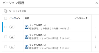

Make it up-to-date
For example, suppose you have Version 1 (V1) and Version 2 (V2). If you want to bring V1 back to the latest, select V1 and select Make Latest. In this case, V2 will not be lost, but a copy of V1 will be placed on top of V2, so you can rest assured.

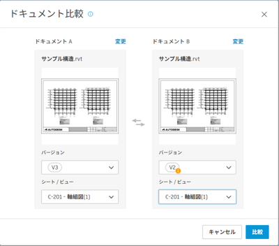

Comparison between versions
Basic operations for comparisons
You can compare what has changed between any version. (e.g., V2 vs. V7)
  1. Right-click the file and select Open Version History
  1. Check the two versions in the version history you want to compare and click Compare versions
  1. Select sheets or views you want to compare and click Compare
  1. The view is displayed in green for added elements, red for deleted elements, and yellow for changed elements
