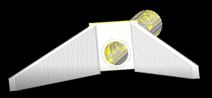

  2. Connecting Daylight to the Last Target Surface
    Problem: Many users find it tricky to connect daylight to the last target surface in Subassembly Composer.
    Solution: Try using an auxiliary point that extends past the surface, then daylight back to capture the last intersection point. This makes sure you're hitting the farthest crossing.
    Image courtesy of @BrianHailey
