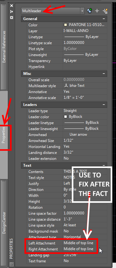

Post a DWG sample then: I have to be able to recreate the problem in order to help try and fix it. Is that an option?
Otherwise, two ways to fix the problem. First, in the MLEADERSTYLE definition. Second, using PROPERTIES. See both graphics below.

My settings are as you indicated, except that I don't want them to always left justify, I want them to justify automatically depending on which side of the leader they're on.  I've attached a dwg with my mleader.  The top one is unadulterated, the bottom one has been set to right justify in the text editor, as you can see if you select it.  It has an extra grip on the top right.  The left and right attachment settings remain the same in the change properties box becuase the change was made in the editor, not on the overall entity.  The change property box does indicate that it is right justified, but will not let you change it, it just flips back to right.
