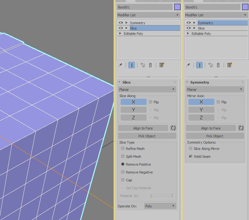

Also experiencing this and it appears to actually be the 'Slice Along Mirror' option that's at fault. It is welding vertices that are extremely close together (even if Weld Seam is turned off).
There seems to be no workaround for this and it has made the symmetry tool practically useless for anything with small units of measurement... Hope this is fixed soon.
Weirdly if you load up a 3dsmax 2021 scene that has a Symmetry modifier, this problem does not occur (and 'Threshold' appears as an option again). Older scenes must be using some 'legacy' version of the symmetry modifier. I wonder if there's a way to recreate this in maxscript.

For those looking for another workaround, I just discovered that the Slice tool does not suffer from this problem. What you can do is the following:
  • Add a slice modifier to your stack with Remove Positive turned on,
  • Add a Symmetry modifier on top and uncheck Slice Along Mirror.
This basically mirrors the Max 2021 way of symmetry without welding-snap issues (at least to the scales I've tested).

I did notice that the threshold was removed and assumed something smart had been done in the background. As I mentioned before, This issue doesn't actually seem to be with Weld Seam, but with Slice Along Mirror. When this option is turned on, the slice is performing some kind of weld of close vertices, but provides no threshold option. Here's a video I posted elsewhere:
You can see those two very close vertices merging when Slice Along Mirror is toggled on and off (and you can see from my previous post that this same issue does not happen if using a separate Slice and Symmetry-without-slice-along-mirror modifier stack). My experiments show that it's welding everything with a threshold of roughly ~0.08ish.
