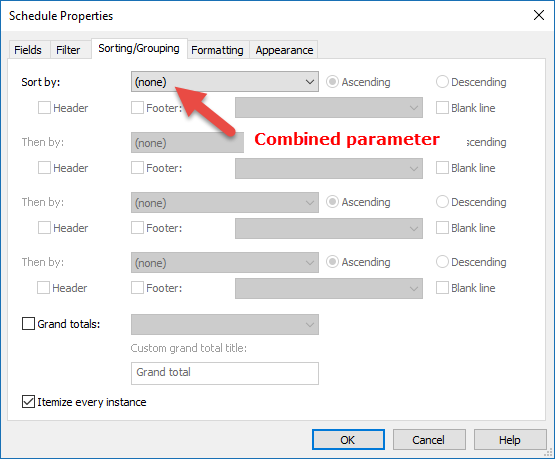

Use Combined parameters in Schedule Filters and Sorting.
Unfortunately, a Schedule allows you to sort on only 4 parameters.
There are several cases where this is not enough.
In 2018 we can use combined parameters in a schedule so we can combine as many parameters as we like.
It would be very welcome if we could use a combined parameter in the Schedule sorting list.
So we can create our own unique key and sort on that parameter.
It would also be nice if we could use the combined parameter in the filter option.

I recently created a Calculated Value in a R2016 Structural Framing Schedule so that I could sort and group the results by Reference Level Elevation, but also show the Reference Level (name) in the Header for each sorted group (fields hidden to conserve space). I had to hardcode the values in the formula (which makes it very fragile, see below), but even if the "Combined Parameter" (from R2017+) was available to me, I'd still need my workaround (since you can't sort/group by Combined Parameter).
My formula, as an example:
if(Reference Level Elevation = 0 mm, "0 - First Floor", if(Reference Level Elevation = 4900 mm, "4900 - Second Floor", if(Reference Level Elevation = 9800 mm, "9800 - Third Floor", if(Reference Level Elevation = 14700 mm, "14700 - Fourth Floor", if(Reference Level Elevation = 19600 mm, "19600 - Roof", if(Reference Level Elevation = 22900 mm, "22900 - Stair 1 - Roof", "?"))))))
An alternate solution to my problem would be to simply allow me to concatenate the Elevation and name parameters (with a " - " in between) in the Calculated Value, per this idea: Allow text in formulas (assuming it's implemented properly).

I hope this gets implemented, Not being able to at least sort by combined parameters has been a pet peeve since they were added, since it would make for clearer header values and free up sorting slots in the schedule formatting.  Being able to do so has become more important with Revit 2024's addition of scheduling revision comments.  "Views: Sheet Number" and "Sheets: Sheet Number" are different parameters, one for revisions in views, and the other for revisions on a sheet.  Combined parameters can report the sheet name and number regardless of revision location, but since combined parameters can't be used to group data a project with mixed revision locations can't group comments by sheet natively in Revit.

The latest versions of Revit allow Combined Parameters in schedules, however Combined Parameters are not available for use in Sorting/Grouping or Filter by selections.  Calculated values are available in Sorting/Grouping and Filter by selections, why not combined parameters?
This could prove to be very useful given text string operations are still not available to us.
