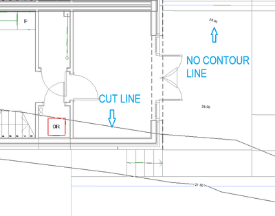

When creating a plan view in which the contours of a toposolid are shown, the view depth cut level will always be near the finished floor level or lower.
Because the proposed or existing levels near a building will in many cases be higher than FFL this results in the toposolid getting truncated.
There is no option in Revit to show the contours above the view cut without using a workaround (some listed here Make an object not cut by view range? - Autodesk Community)
By default all the contour lines surrounding a building need to be show even if they are higher than FFL.
Can anyone think of a situation where a construction drawing showing existing or proposed contour lines would be truncated?

will_young
Sorry for the poor quality image. The line marked 'cut line' is where the toposolid is cut by the view. There is no option in Visibility/Graphics to turn this line off. It looks like a contour line which is deceptive. No further contours are shown for ground levels beyond this point yet the contour labels do display.
It would be great if this erroneous situation can be coded out somehow.

If the image looks odd it may be because I'm using a linked dwg from the architect to show the GF layout of the plot.

@will_young  This whole thing doesn't make sense to me, why would a toposolid exist where the building footprint occurs as this would be a flat pad right?  Are you taking advantage of excavation tool?

Thanks for the suggestions Mark. I wonder if a lot of the pushback on this idea is coming from architects who are looking to visualise the topography whereas possibly the people who don't want the toposolid cut are looking to produce engineering drawings, in my case I need to show the existing ground level contours on our foundation plans.
