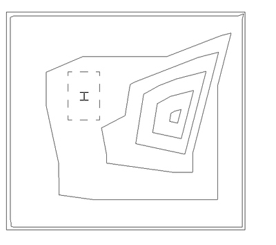

arq_42
Is this what you're referring to?
Do you need to maintain the view range by cutting through the foundation, but still see the projected toposolid as if it were a top floor plan?
I'd do it with View/Create/Plan Views/Plan Region.
Since you can't create a nested loop, I've done a little trick by connecting them with a 1mm gap.
What I still don't know is why when modifying the sub-elements the corresponding layer is no longer seen in plan, and instead it appears as if you cut the upper layer

Yes I wanted to show the contour lines of the toposolid as it would appear 10 feet higher than the current view's cut plane. I did this by creating a plan region around the exterior of the building and had to fake some line work. Wish there was an option to have objects have their own view range
