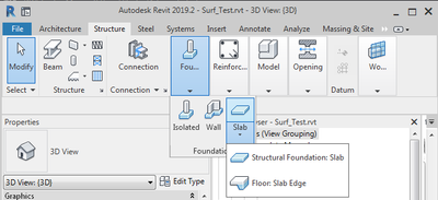

It would make life so much easier if they allowed us to nest pulldownbuttons inside pulldownbuttons (like most websites use as well).
(actually this kind of behavior already happens if you have multiple pulldown buttons in a ribbon panel and resize a windowed Revit instance to a very small one; Revit will automatically compress pulldowns inside pulldowns)
E.G:
