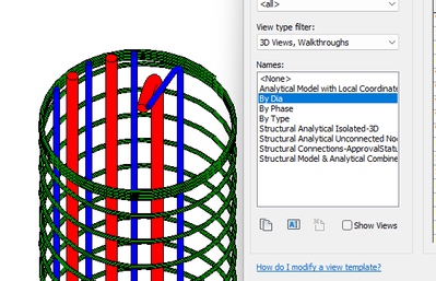

This can easily be accomplished with templates as below screen shots.
You can then easily view required to relevant template.

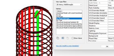

with a bit of work you can even combo like phase and type as per last screenshot
ipselute
@wr.marshall : Of course you can. That's not the point. Other software like Tekla and Allplan already have such templates in the default installation. Revit is the only one that hasn't (yet). This is the kind of OOTB content that makes the difference between a good software and a great software. Because such templates saves a LOT of time for the average user. I don't wanna waste my time creating such templates. An average engineer should focus on engineering, not on creating new standards and templates.
