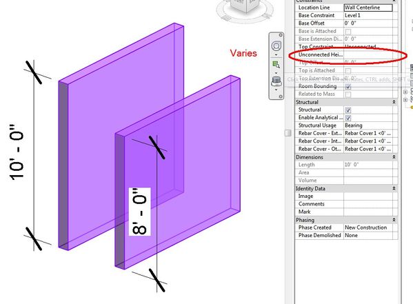

When you select multiple instances of an element and if they have different parameters it would display 'Varies' in the parameters value rather than a blank white box that appears to be an empty value.  .

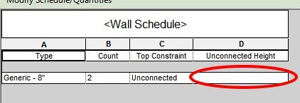

This would greatly help when you have items in a schedule that are not sorted with  'Itemize every Instance' checked

This is a user interface/QC disaster waiting to happen when a schedule is not set to "Itemize Every Instance" and an unsuspecting (new) Revit operator changes the ID tags or what-have-you on hundreds of components all because the cell was "blank."

For me this would be useful to have this for my length parameters for light fixtures.  It is impossible to schedule every single length for fixtures that are for example in a cove, or LED roll out strips for display cases, under eave or decorative areas...this could equate to 30+ types for the same exact fixture.  I just leave that portion of my schedule blank instead of typing out each instance with a general note to verify fixture lengths shown on plans, but I still get RFIs for this.  I would like to see the same for my multivolt option as well where I have a fixture that can be 120 or 277.  This option would be great for all disciplines.

  1. The desire to purposely return and show that the cell has multiple values, e.g. lengths of items in a non-itemized schedule. This could be done with a logic that says, "IF MULTIPLE VALUES, REPORT __________" where the user could fill in their own value, e.g. "VARIES" or "MULTIPLE".
  2. The desire to at least show within the properties of multiple-selected objects or within a non-itemized schedule that the parameter simply contains multiple values and is in fact not necessarily blank for all selected items, e.g. <MULTIPLE VALUES>.
  3. For bonus, similar to item #1, the chance to report a value if the cell is indeed purposely left blank, e.g. round inlet diameter parameter on a square neck grille in the schedule, e.g. "N/A" or "-".  (How many of us have to put text on top of a schedule to appease the engineer...?) Granted, now with the ability to concatenate data in Revit schedules, we can handle the round/square neck inlets a little better if we want them in the same column.

<varies> is the answer

We would use it for marks, rooms, comments etc: it would allow us to combine rows in schedules without losing important values in some of the fields. For example: schedule items (chairs) and have a field that lists all the rooms it was placed in.

Basically, in schedules, I would like to have the option to chose what to do when a value varies:
- enter a label (could be blank by default so the current behavior would still be an option for people who want that, but could also be 'varies' or 'varieert' (in Dutch))
- list the different values
When viewing the value of a parameter (e.g., "comments") in the properties pallet after selecting various objects in a model: if the objects have different values, by default, Revit displays a blank field rather than providing a message (e.g., "multiple values selected"). If you fill something to the blank field, it will overwrite all values with the newly entered one. If you do not know that some objects already have values filled out, you will not know that you have replaced them with a new value.

For schedules there are a number of ideas (including one of mine) for allowing a cell with various values to list them instead of being blank.
It has been suggested we should have the option (for schedules) of having a multi value cell blank, return "varies", or list all of the results. This would be a really useful addition to scheduling, allowing much greater flexibility in how we present data.

Adding to this. Another option that may be nice to show a range (24-64m²) or (maybe even a labelled average?) in addition to a custom string or a hard-coded "Varies" text when dealing with number values.
jkidder
@blro. There is an option to "Calculate Minimum and Maximum" in the format tab.  It will show the values as "24 SF ... 200 SF"
