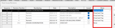

That said (sorry for mini rant 😛 ) I have tried a few of these suggestions...sadly the simplest and fastest I find is:
- using a dedicated notation for all markups and just "select all instances in project" and hide before printing.
Not to just complain though....
Another proposed workaround is the following:
Using the "SHEET ISSUES/REVISIONS"  create a custom number that is not congruent with your issuing number sequence.  example: DC1
(you will always have a blank space in the date column)
Basically at start of project you set this up and then apply to every sheet in set so it is consistently the first place holder(either by pyRevit or manually placing cloud off of sheet). unfortunately it will always show in your revision column so name it something generic as you cannot cover it with a masking region or solid white filled region.
With this method you just cloud the area under discussion and then fill out the comments in the Properties column.
So when you're wanting to print without these notes/clouds just change the "show" column from "Cloud and Tag":
to "None":
Going one more step you can create a schedule that shows you sheet location and comments which can be useful in meetings or reviewing project. You can even add extra column for solutions/direction to drafter from reviewer. (skys the limit)
and then you just add/edit/delete as you coordinate.
....sidenote: above in the "SHEET ISSUES/REVISIONS"....the green arrow is just pointing out that this "DC2" is just located on our cover sheet and the date is revised each time we run a progress/check set. It is always moved to the bottom of the list.
and to incorporate you can either draft a revision cloud off of the page or I use the "pyRevit" plugin/addon to do the same thing.
I don't know if this is clear but I hope someone might find it helpful.
