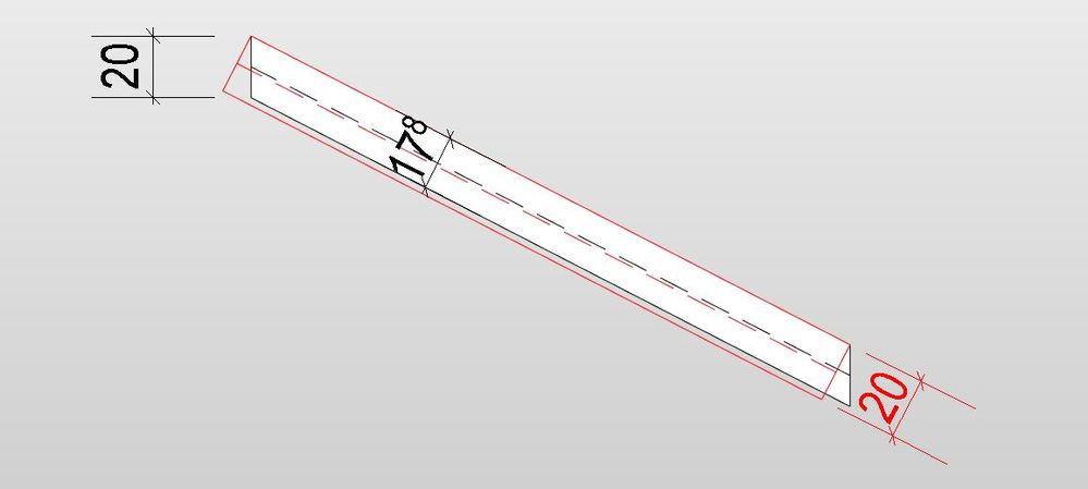

Current situation: Using modify subelements on a floor with non-variable thickness results in a constant vertical thickness. This causes the perpendicular thickness to vary according to the slope of the floor. See screen shot.
Desired situation: The thickness should be kept constant perpendicular to the floor. Thereby maintaining the thickness used in structural calculations.
9 Comments
iCs-tna
In "structural"-sense the thickness of a floor is perpendicular to the surface (red). Unfortunately Revit constructs a floor with a "vertical thickness" (black). It would be nice to have the option, that the floor thickness is perpendicular to the surface, also because the structural axis are differen (dashed line)

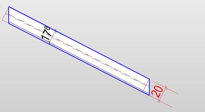

Just a small side note: I would still like the opportunity to have vertical edges with the constant perpendicular thickness, shown in blue.
