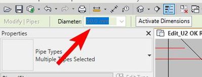

16) „Diameter” field unnecessarily highlighted
While drawing hvac installations this field is constantly highlighted. Normally a highlighted field in any other program means thaht there is focus set to this tile and the user can start typing (but not in Revit).  So this field should be highlighted only when the user clicks it.
