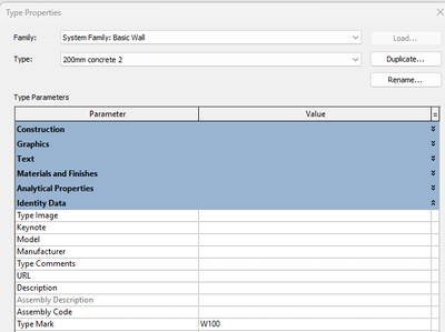

Not entirely sure if this is a bug or a feature, but the behavior of the "type mark" parameter when duplicating a component is different in different components. This happens in all recent Revit versions.
Please make it consistent! (I would personally prefer it if it was cleared when duplicating.) Possibly add an option somewhere where you can select which behavior you want.
I haven't tested every component, but I have tested these:
Walls, Foundations, Floors: Type Mark stays the same.
Columns, Beams, Generic, Structural Connections: Type Mark is cleared.
Windows, Doors: Type Mark counts up one.
