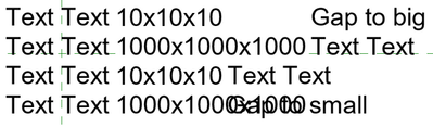

Though a tag would work there are holes in that methodology, with the outcome having to create and save multiple iterations in many instances to suit.
(1) alignment of text: though you can get text and labels reasonably aligned they will never truly be aligned.
(2) creating spacing gaps for parameters that will change. As can be seen in the top 2 lines the spacing gap is too big for the top line but satisfies the requirement for second line. In a similar instance, but on opposite end of the scale, on the bottom 2 lines the spacing satisfies requirement for line 3, but starts overlapping for line 4. Thus you would have to create multiple iterations to accommodate all possible outcomes.

Listen, its already possible.
Numbers 1 and 2 would be issues even if you used text instead. You'd still have to resize whatever thing you've created if there are too many characters. I'd suggest making a couple of types in your tag family so you can resize with two clicks rather than opening up the family and editing it every time. For instance, I have short, medium, and long types within my door tag. On top of that, I have a Dynamo script to automatically resize all of them based on how many characters are in them.
Number 4, you can make text wrap in tags.
Numbers 3, 5, and 6 are only issues if you don't understand how BIM works. Its on you if you're using different tags for every single project. Instead of recreating tags, or any family for that matter, for every single project, make some firm standards and stick to them. Sure, you can make something from scratch if you have some out of the ordinary condition that absolutely requires it, but this shouldn't be common.
