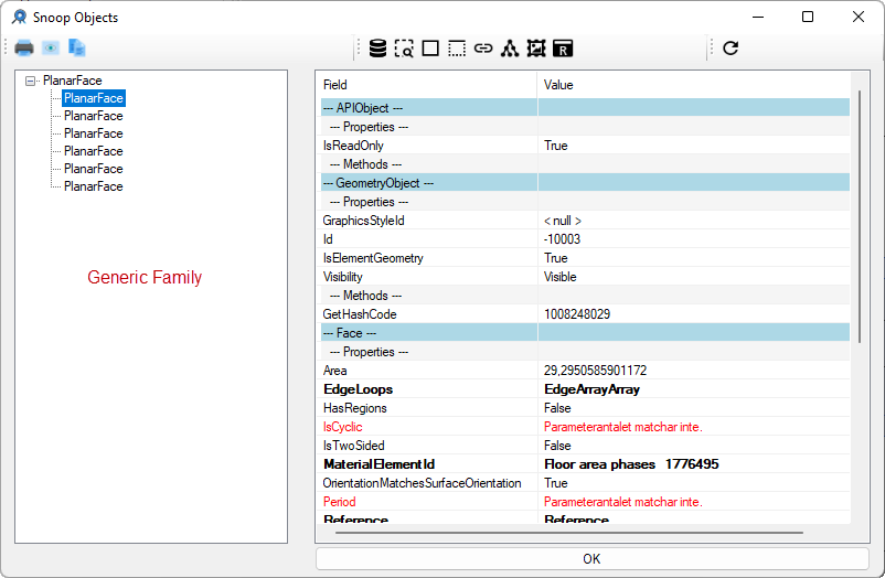

When I looked at each face on the direct shape with ‘Revit Lookup’ add in. I see that the cut face gets MaterialElementId = null.
When I do the same with a Family that is a Generic Model the cut face gets the same material that is applied.
Even did the same thing with a Family for a non cuttatble category, Furniture, the MaterialElementId = null.
The wall in the picture is made the same way you did trough export a SAT-file.

angel_velez
Geometry in Revit is a shell.  The faces of the geometry have materials applied to them.  A DirectShape does not have a material associated with it that is independent of the material of the faces of the geometry - there is no API to set that.  So if logically if you wanted a DirectShape to represent a piece of wood painted red, then the DirectShape should show red faces unless you cut it, in which case you would see the wood.  But there is nowhere in Revit that you can set that the DirectShape is wood material.
Are you saying that it would be sufficient for any DirectShape to have one material assigned to it which would be the material that is used if the DirectShape is cut?
jolr
@angel_velez   Yes, it would be great to be able to assign a cut material for DirectShape.
Thank you.
