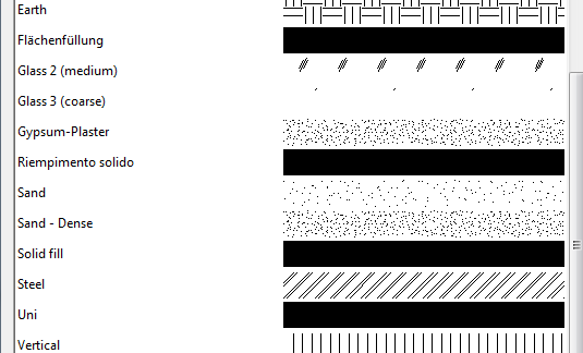

After inserting files, created in a Revit version set to other languages, you end up with duplicates for the solid fill pattern.
There's no way to delete these duplicates. I understand you need at least one solid fill, but we should be able to delete the others. For instance, the ones not matching our language settings.

@sasha.crotty I've treid to repredoce the problem. It seems to be related to older Revit versions (oldest I have in 2016, so I can't check). In Revit 2016 and up, the program seems to recognise when a "Solid Fill" is being added from a family but with a different name. Other fill patterns do transfer to the project
Thus the problem seems to be resolved, but this doesn't change the fact that when working in older Revit projects, you can still be stuck with duplicates of the Solid Fill.

This issue has been resolved in Revit 2021 to remove duplicated solid fills.  Once you upgrade the project to 2021 they will be gone.
